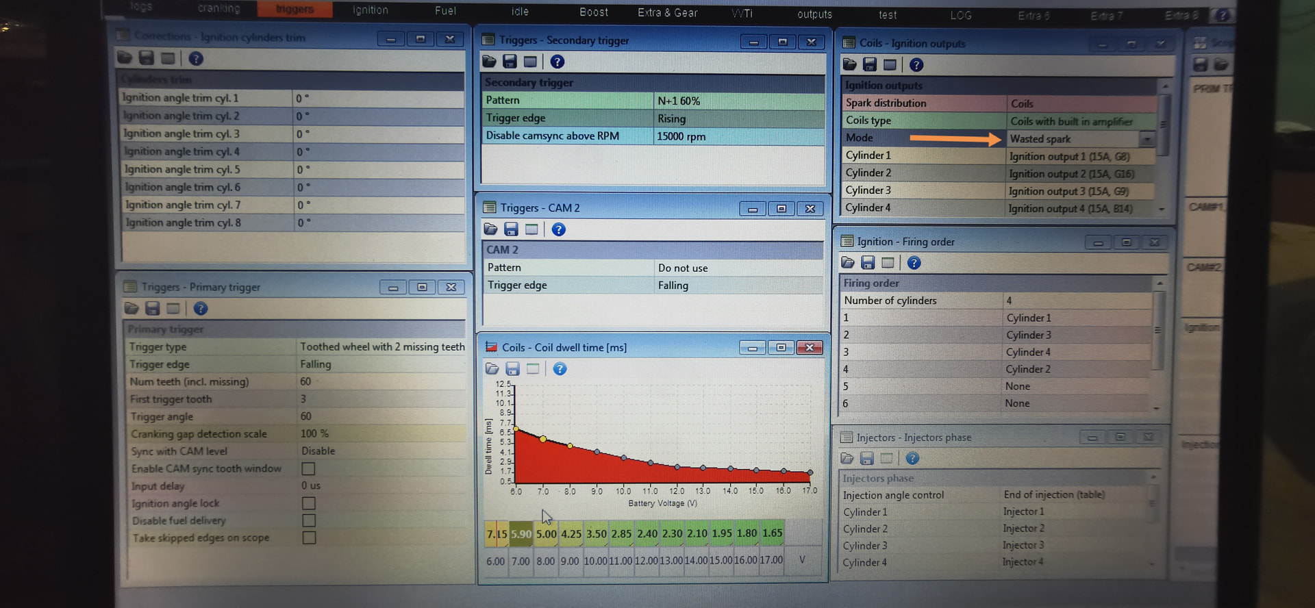

Hi all i wounder why the engine not starting when i choose mode sequential but is only starting in waste spark mode?
Hi, that means ur engine phase is inverted. Sequential injection will also inject at the wrong time.
Thanks dear, for the explanation i will keep it this way then.
No need…u can fix this.
In V3 u judt need to set “engine phase inverted”.
In V2 there is somewhere a offset variable for firing order….i think u need to set this to 2. Just try it.
Yes its v3 do you have a screenshot where to change to inverted thank you.

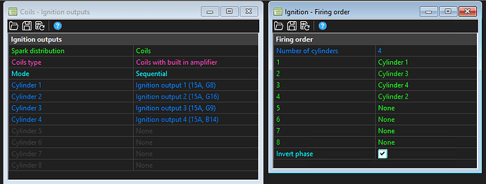

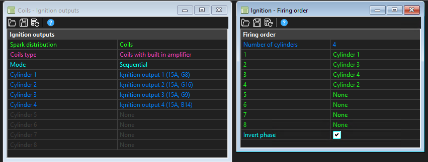

I’m also running my 1.8T BAM on emu black V3.
I also had to change the engine phase to inverted and if I remember correctly I had to set the Coils Type to “coils with built in amplifier” (From what was set in an empty project.)
Here are my firing order and ignition output settings:
Thanks Patrick for the share its working mint now i really appreciate it.
