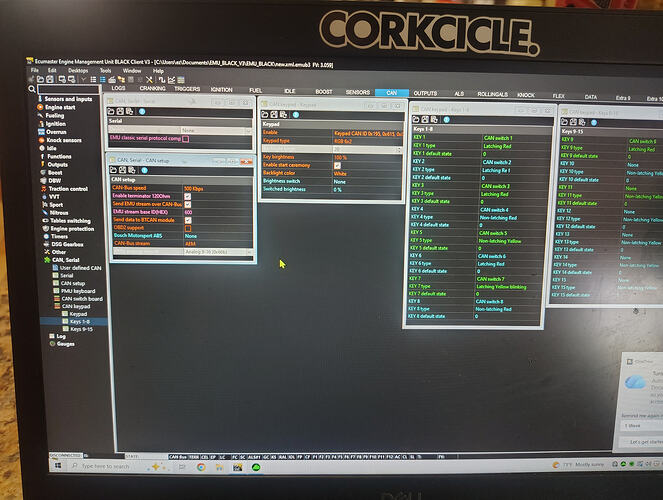

Got the V3.059 and got it setup. I got it running but on my CAN Dash display AEM CD7 it’s not showing coolant temp, rpm, and throttle position. Funny thing is that those missing are showing on my laptop but not on the dash. The dash does show boost, afr, oil pressure , battery , and afr target. I have picture not sure how to post them. Thanks
What can stream did you select ?
here is my can windows

The fixed firmware will be published tommorow.
Please use the following firmware 3.059.01
https://www.ecumaster.com/files/EMU_BLACK_V3/emuBlack_3_059_01.zip
:+1: Firmware update is installed and all of the perameters are working on my CAN dash. I also found a spelling error in one of the help windows. I will post it if I run into it again. Thanks for the fix.
