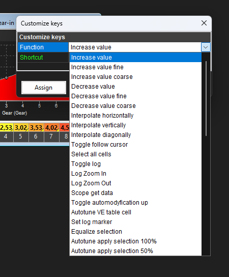

Hi, looks like when customize keys list repeat itself 2x and I can not change key because its already choosen..
See attached pictures

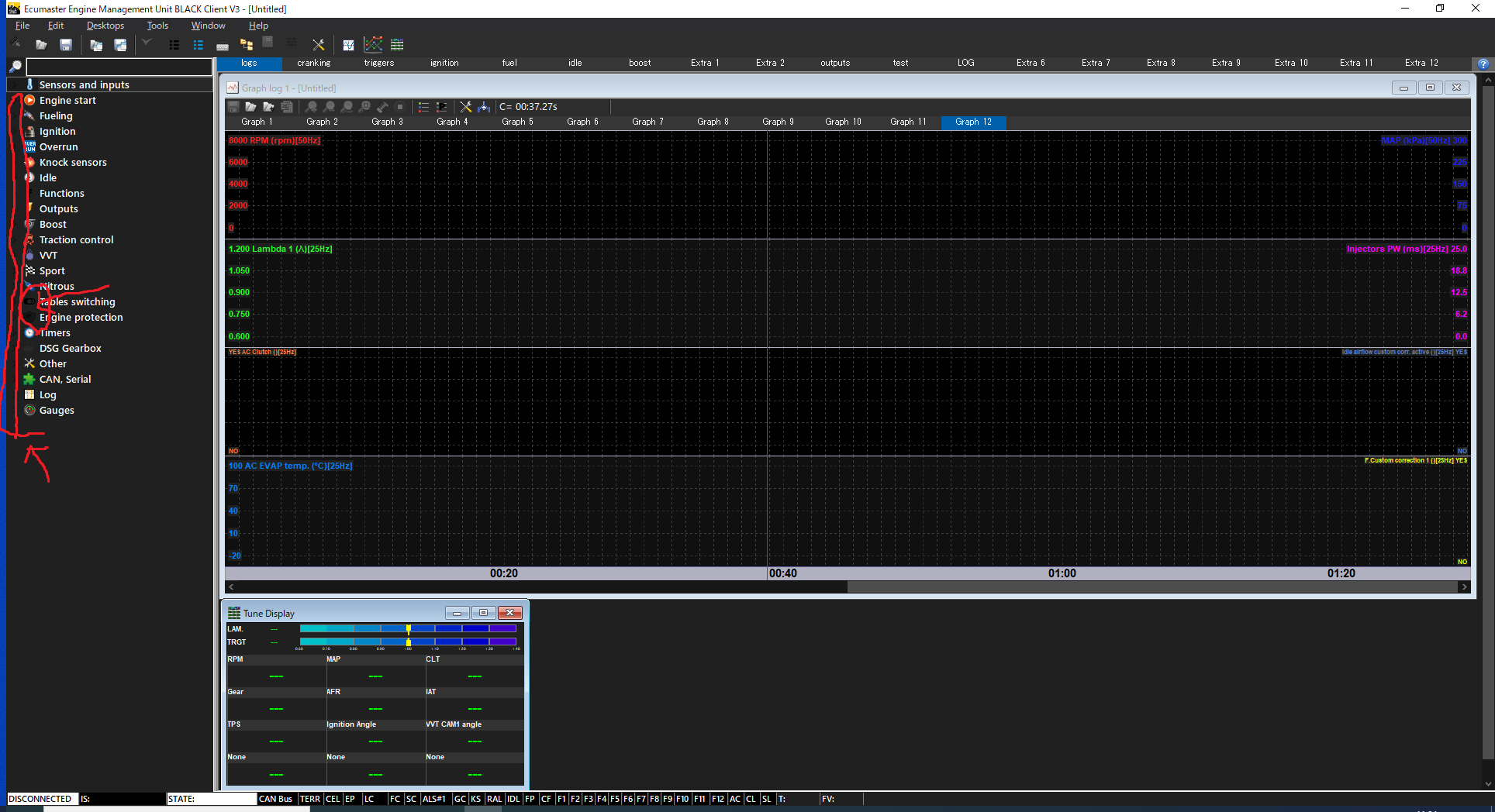

On my Windows environment, when I use dark mode, some of the menu and icons on the left side are black and very hard to see, but when I see other people’s posts in a Facebook group, they are clearly visible.
Is there a way to change this color in the menu somewhere?

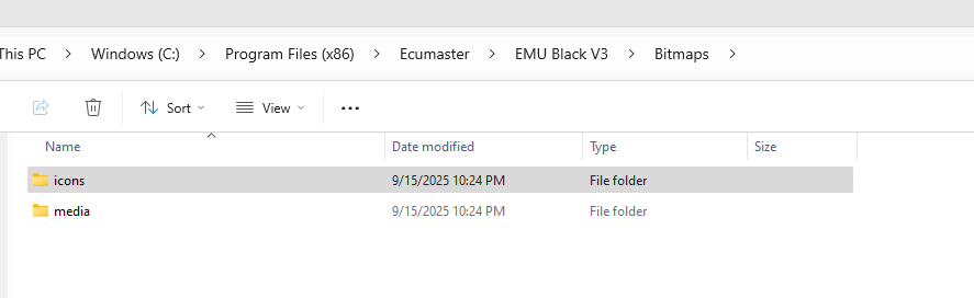

Please check the directory:
“c:\Program Files (x86)\Ecumaster\EMU Black V3\Bitmaps\”
There should be the following subdirectories:
icons
icons_darkMode
media
It looks like you dont have icons_darkMode directory.

I don’t have the icons_darkMode directory either.
I tried an uninstall and re-install to see if it was a symptom of an upgrade from the previous version. That didn’t fix it either, still no icons_darkMode
Fixed installer - fixes the problem with the icons in Dark Mode
