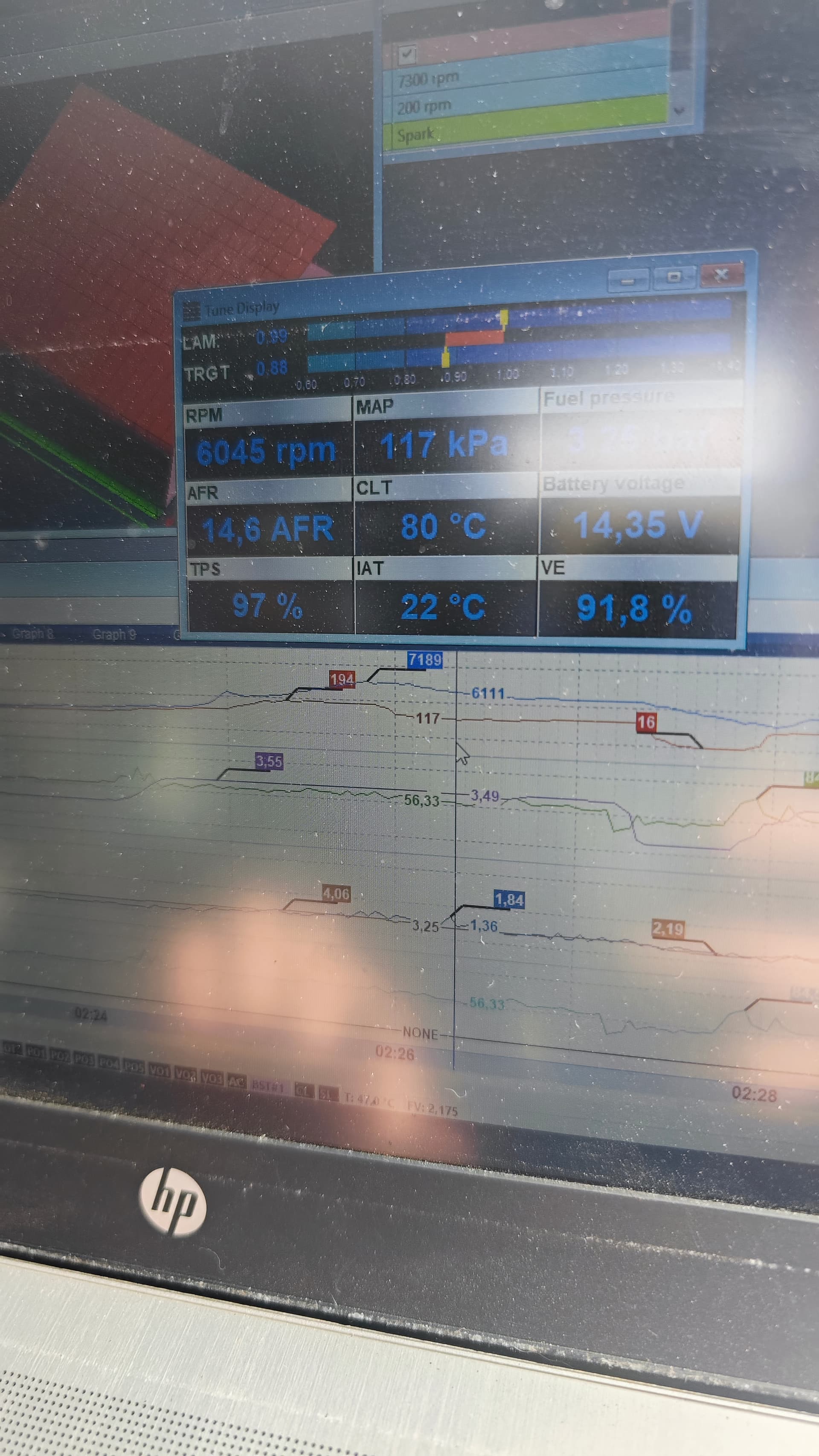

Hi everyone, I really need help. I don’t understand where to look or what to do. There’s a separate harness for the throttle, it’s intact, the lithium battery is fine, and the ground to the body and engine is new. The problem is that the throttle doesn’t let me rev up to the redline. If I hold the rev limiter at 7000 rpm, everything is fine. If I reach 7200 rpm, the redline should be there, but no, it just drops the revs and holds at 4-5000 rpm and doesn’t let me rev up, just hold and slowly rise like 4500-4550-4600. I even experimented with setting the redline at 6000 rpm, and it’s exactly the same. If I’m driving straight, the redline works fine. If I’m standing still, the redline works fine. If I’m going sideways or drifting, the redline doesn’t work.

Can u share a log?…Is DBW not reaching its target position?
Some time ago i had a similar issue…there the throttle couldnt reach its target position randomly. I then improved my grounding and the issue was gone.

I don’t see the CLT temp on your logs but the IAT is heat soaking right before you are unable to rev the engine if I’m seeing this right.
I think you should log the pedal if you can and the CLT to help better constrain the problem.
But you do have CLT protection enabled 105°C for high temp limit. This will stop you from revving past 5,000 RPM.
In log file, there is a CLT, it is stable at 80-85 degrees, that’s how my PWM is configured, If off the sensor, it will follow the 60 degree configuration.

Okay. I took another look at the log. Check out the AFR when you are unable to rev the engine.
I see the AFR is ~12 when you first hit the throttle. About the same the second time. The third time, it looks like it is 15 which is probably way too lean (because it is warm) and then it just gets worse at each blip of the throttle.

Thanks for the info. Yes, ideally, I need to connect a second channel that will function as an inverter, but all my ECU outputs are full. The throttle can work without an additional channel, so it’s a backup channel. I don’t think that’s the problem. You can look at the 3rd minute and 7:10-7:20 in the log file. There’s a moment where the Tps is 100% but the bdw closing. The some times is due to me pedaling at some point, but with the pedal fully in the cut off, its logical that afr would go to 15.
