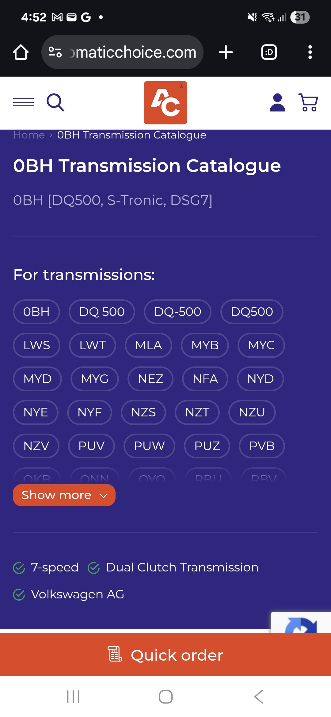

If you can find the mechatronic part number like starting with 0BH might be it can be identified.
Can I run a 2014 tiguan NZT code?
2014 seems to still be PQ35 which should be supported BUT, NZT does not look to be a DSG. I assume you are North America based, DQ500 was not used for that market in first gen Tiguan at least from what I know.
I am in Australia
0BH is mostly PQ35 as per my knowledge but can be also used for MQB on the transition years 2014-2016
This is from a 5n tiguan
Yes, it work. PQ35 platform gearbox
I’m in the US so no 0BH DQ500 available here. Is it possible to just swap an 0BH mechatronics and speed sensor into an MQB DQ500?
