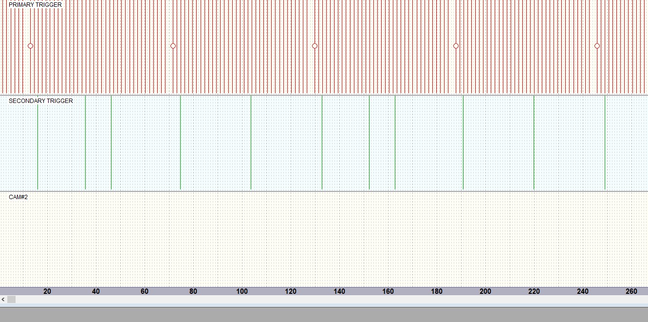

I set the trigger to “missing tooth”, Synchronization works with this setting.
However, cam1 angle 390 was shown in the VVT log, I don’t know if that’s ok.
I put a scoop picture, is there any difference to your triggers.
