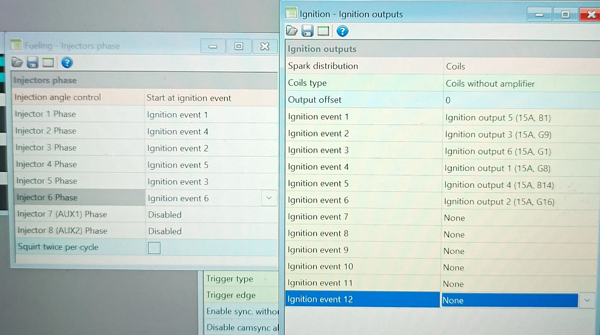

This Fuel injection order is confusing me on EMU Black V2.
My alfa V6 engine Fire order is:
1-4-2-5-3-6
I does not understand This Fuel injection order. What i sould put there.
I resume v3 version is some how difrend vs V2.

I think u are confusing urself. It seems u didnt wire ignition output 1 to coil cylinder 1?
So noone can help u without u sharing ur wiring.
Do urselfe a flavor and wire output 1 to cyl 1 and so on….
I am only asking when it is good Time to ijenction. Engine is runing now Well. I did not use offset to 3. Thats why ignition order is like This.
