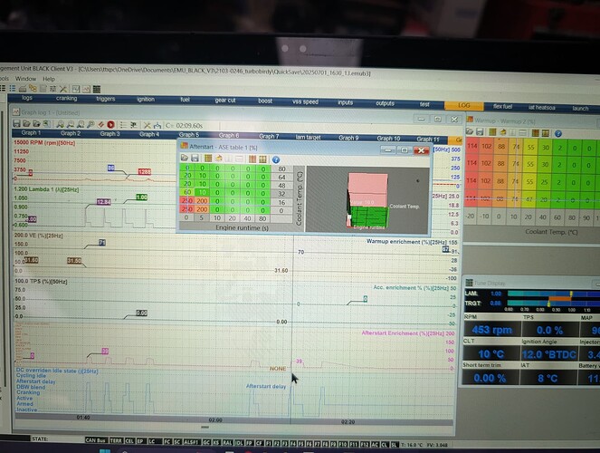

Hi all
I’m obviously missing something, running 3.050 v3, afterstart enrichment seems limited to 39% no matter what I put in the table, not enough on e85, is fine for gasoline, afterstart tables aren’t blended
There is no limitation. I’ve checked and it works correctly.
Could you publish your base map ?
Hi, here is the map
on bike 7_25.emub3 (67.3 KB)
There is a bug. It is already fixed, the new build should be available tommorow.
