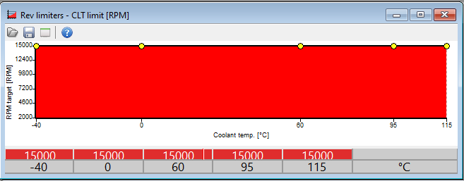

Hi! I am trying to increase the rev limiter to higher than 15000 RPM, but the Rev limiters tables do not accept a higher value than 15000 RPM.
Is it possible to configure a higher rev limiter than 15000 RPM? If not could it be possible in a future SW upgrade? I think 16000 RPM was possible in V2?
What is the technical maximum engine speed that the EMU Black V3 can manage? I remember from the product page it is stated 16000 RPM.
I will increase the range. The maximum RPM depends on the trigger, however for engines with high rpm there are typicaly low tooth triggers (not 60-2).
Awesome thank you! Ok I see, yes the trigger wheel for my engine is 24-2.
