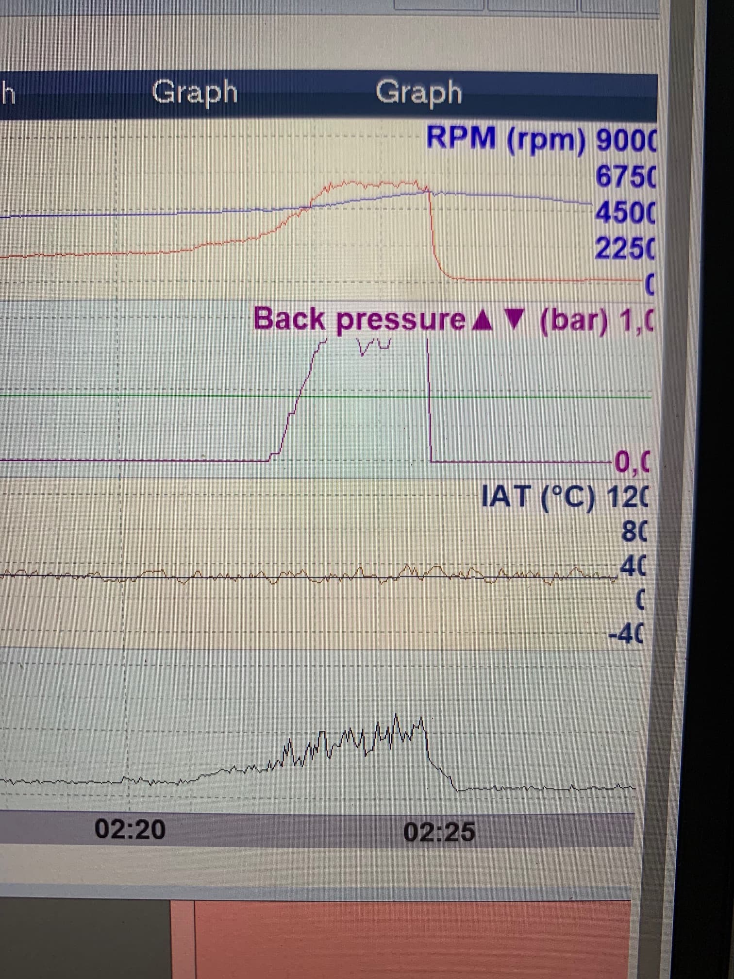

about the knock sensing. on v2 a knock always looks like a real spike. on v3 its all way smoother. is that done on purpose or just a setting problem? i am on integrator 180. so normaly its a really rough graph.
here a log from v2 and v3. both with the same settings. i also needed to pull in .20gain to get to the almost same engine noise on v3. v2 i needed way more quiet. knock in v2 is the lowest graph in the picture. the spikey one
