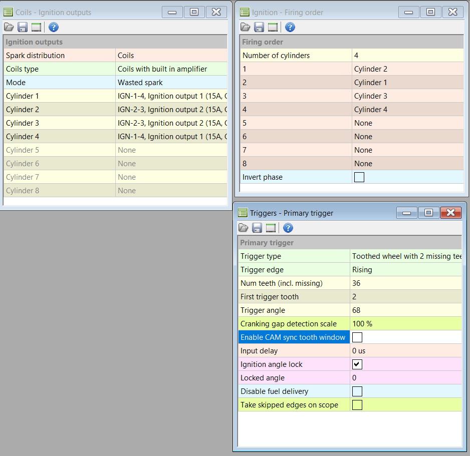

I updated v3 to 2nd car but diferent type of triggerwheel instead of 36-1 in this config Iam using 36-2.
In both version I noticed much longer start - gap detection calibration have no affect to improvement.
I have more revolution than in V2 till ECU starts to squirt and sparks.
In both cars Iam still using wastespark and “squirt twice”…
In case ov 36-2 config i noticed that “quirt twice per cycle” is not applyed even though Iam using recomended setting for that function (in version 36-1 it works).
I would say that car was able to start much faster in v2.
Iam also missing the function “afterstart ignition lock”

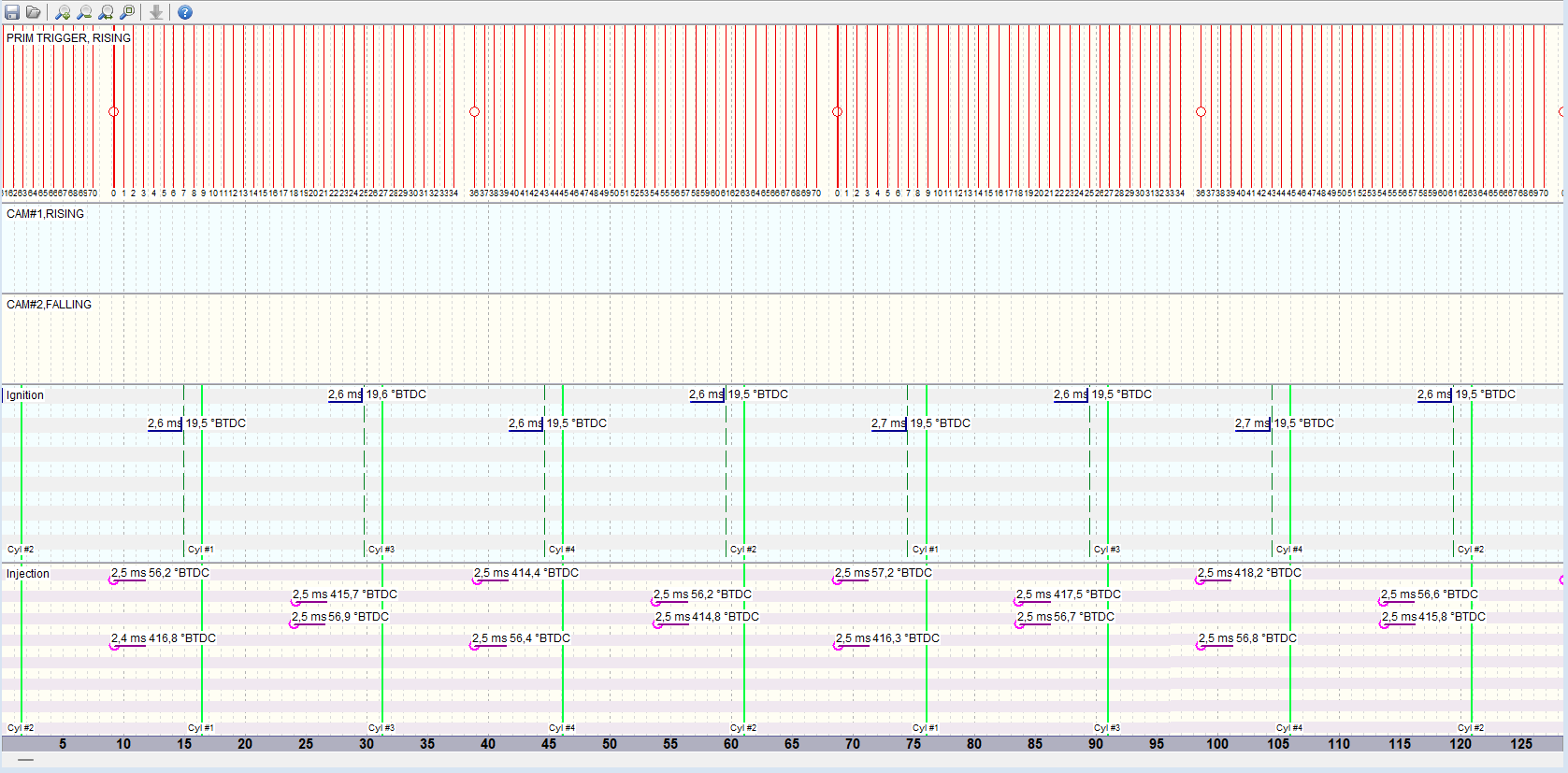

I can see that the spark is performed immediately after sync so it should fire the mixture from prime pulse).
If I will have a map I will test it on simulator.

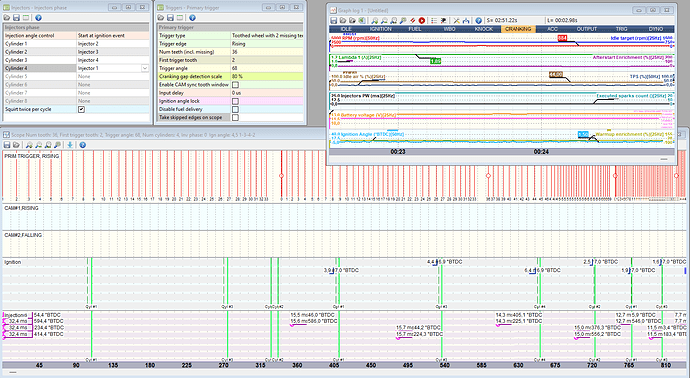

On second scope all injectors work twice per cycle.

Try the following settings. Also disable fuel during cranking and adjust prime pulse to get primed fuel ignited. Then work with the cranking fuel dose.

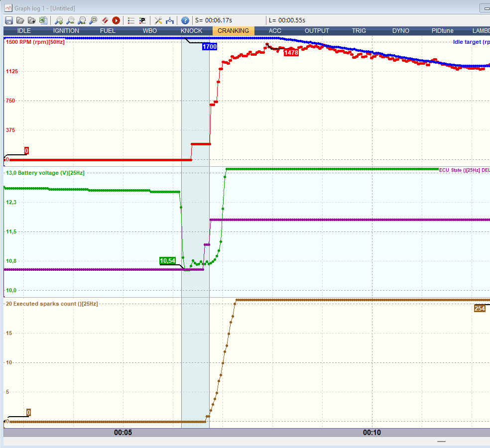

Hello thank you for your crazy fast support.
I tryed your new FW and recomanded settings with no success.
Than I tryed your new FW and my setting and it works.
It works so well that Iam crying and laughting at the same time - Engine runs in half second. Much better than from factory.

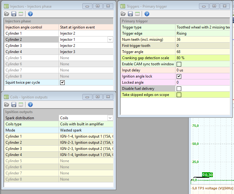

Ok so make it step by step:
  1. Change trigger tooth from 0 to 2 and change trigger angle from 88 to 68
Check if the engine starts.
  1. Change injector phase from 1->1, 2->2, 3->3, 4->4 to 1->2, 2->3, 3->4, 4->1
Check if the enginge starts

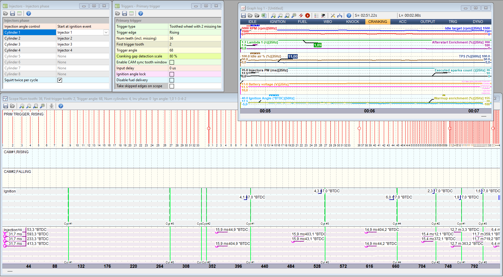

According prime pulse it is executed when firs pulse from the trigger comes.
So you need press the scope button first and then start to crank.
On your socpes there is no beginning of the cranking
in all cases engine starts well.

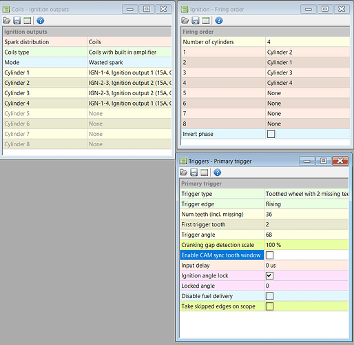

Here you have the results ( I hope my dislexy was this time out so all settings wer set properly :wink: )

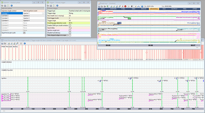

TEST - 1
TEST_1.emublog3 (104.5 KB)
TEST_1.emubscp3 (635 Bytes)
TEST - 2
TEST_2.emublog3 (123.2 KB)
TEST_2.emubscp3 (634 Bytes)

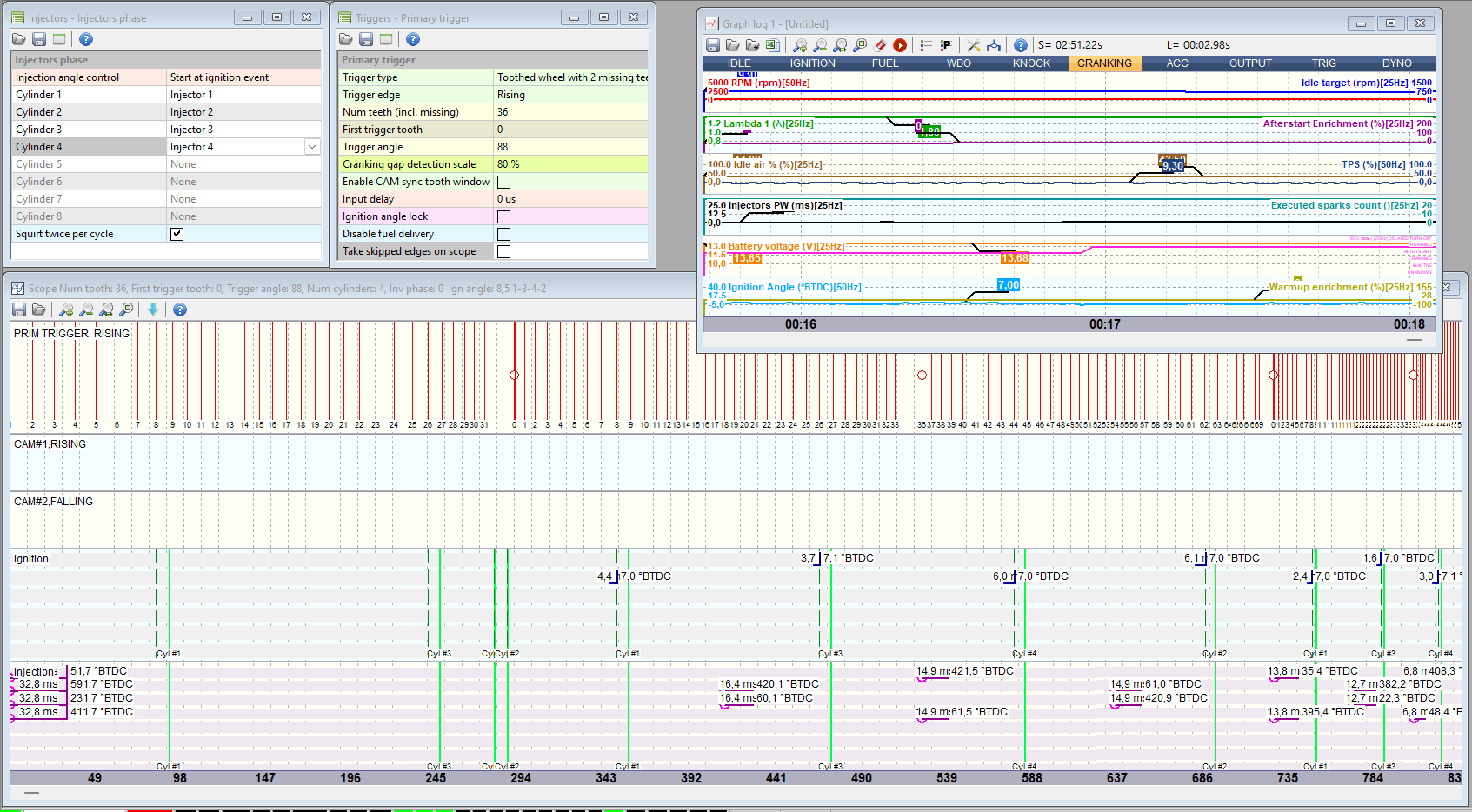

TEST - 3 (“original” settings)
TEST_3 - OrigSettings.emublog3 (155.2 KB)
TEST_3 - OrigSettings.emubscp3 (630 Bytes)
I tought that scope is proceded all the time Iam pressing the trigger button.
Then I realized that when the time frame is out new measurement is made. That was probably the reason.
In new measurements its visible.
the test 2 scope ia the best. keep that settings.

I was setting the trigger wheel position via osciloscope and was comparing the teeth and starter current (A) peak.
In the log that I sent you, whats are the parameters you are looking for to decide that?
Thanks a lot in advance for your answer.
I take randomly only one measurement from each test and all of tests I provided were really similar by driver feeling.
First change (the trigger tooth) makes the first injection faster (before the spark).
In your original file your spark events are offseted with the injectors events.
If you look at your scope the injectors inject fuel but the spark is on a different pair of cylinders. So the second change fixes this.
So both changes should improve engine start, however, I think the prime pulse is working for you.
