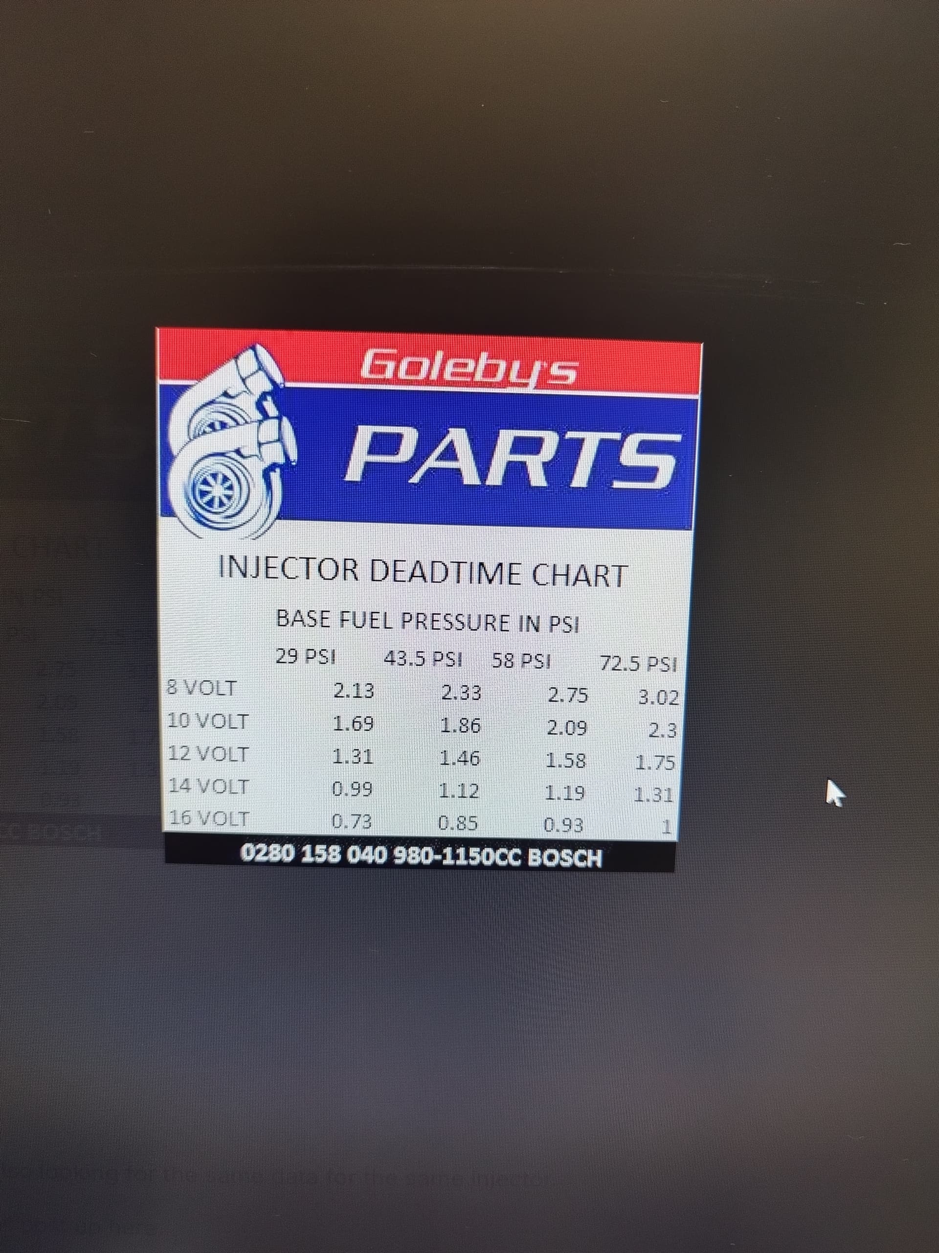

But can we get a injector deadtimes options to add pressure?
I have a car 2 fuelpumps and when it activateds pressure spikes and car runs lean.
On high load its ok. But low loads shouldnt activate the pump i know . But when it does. It needs 30 percent more fuel. 3bar vs 5 bar.
Customer has Manual over write switch on the pump :roll_eyes:
I add no problem. But what is fuel regulation system in this car ? Why the pressure changes ? Is the fuel rail properly defined ? I’m not sure if just a dead time correction helps.
Its just a shitty fuel systeem.
To small regulator and to bigg fuel pumps.
But i have seen similar problem on pwm controlled fuel systems .

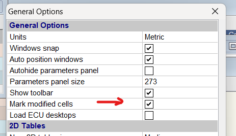

F2 button
Make sure the option “Mark modified cells” is set.
Tables compare
It is planned in the future.
These modified data I can see. But its not possible to reset it via F2 button like in v2 version.
