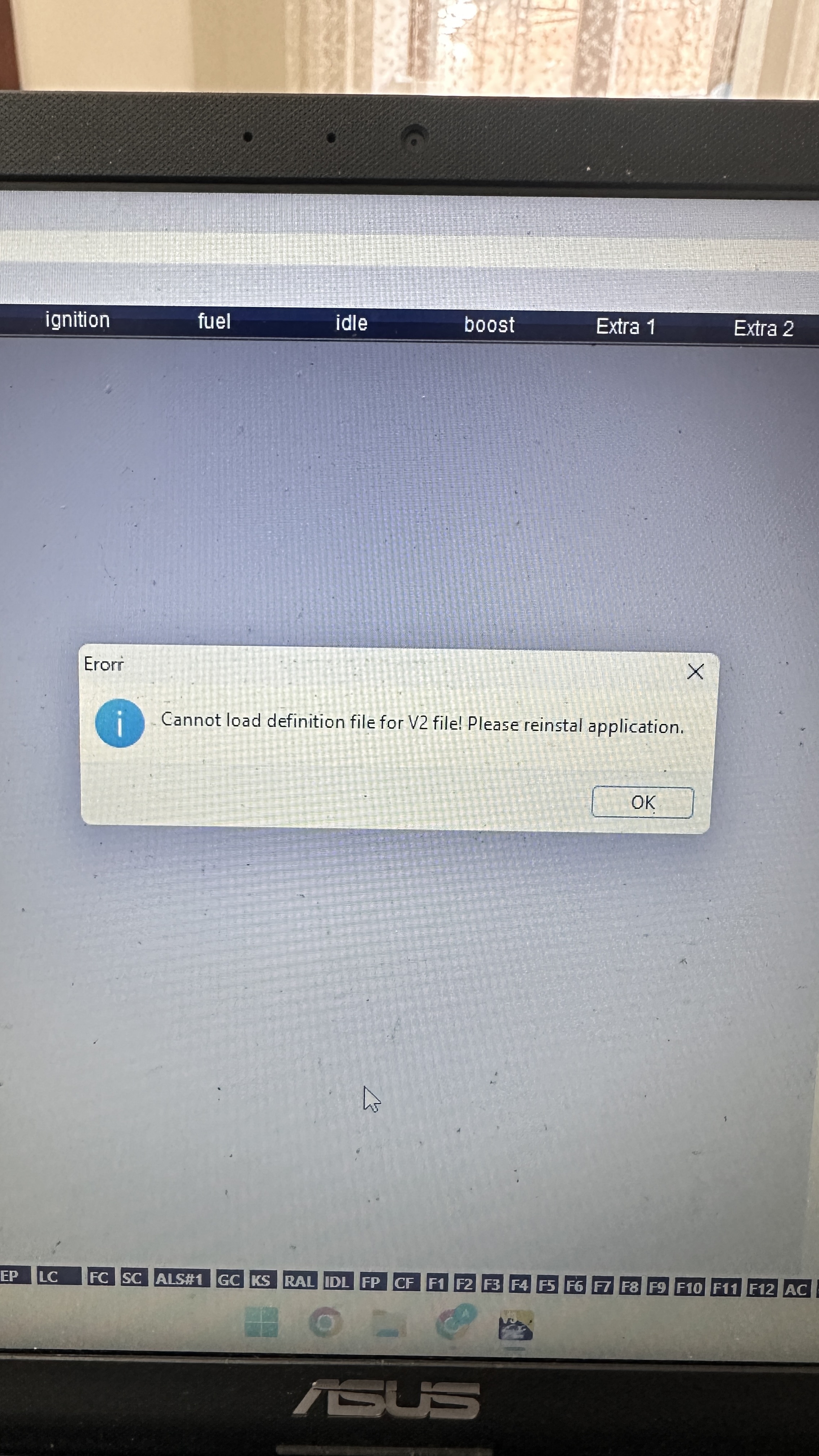

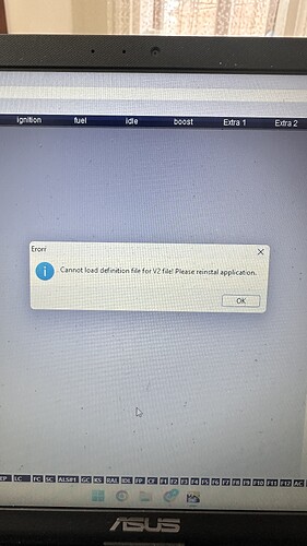

Hello everyone. I can’t convert v2 to v3. This is what it says.

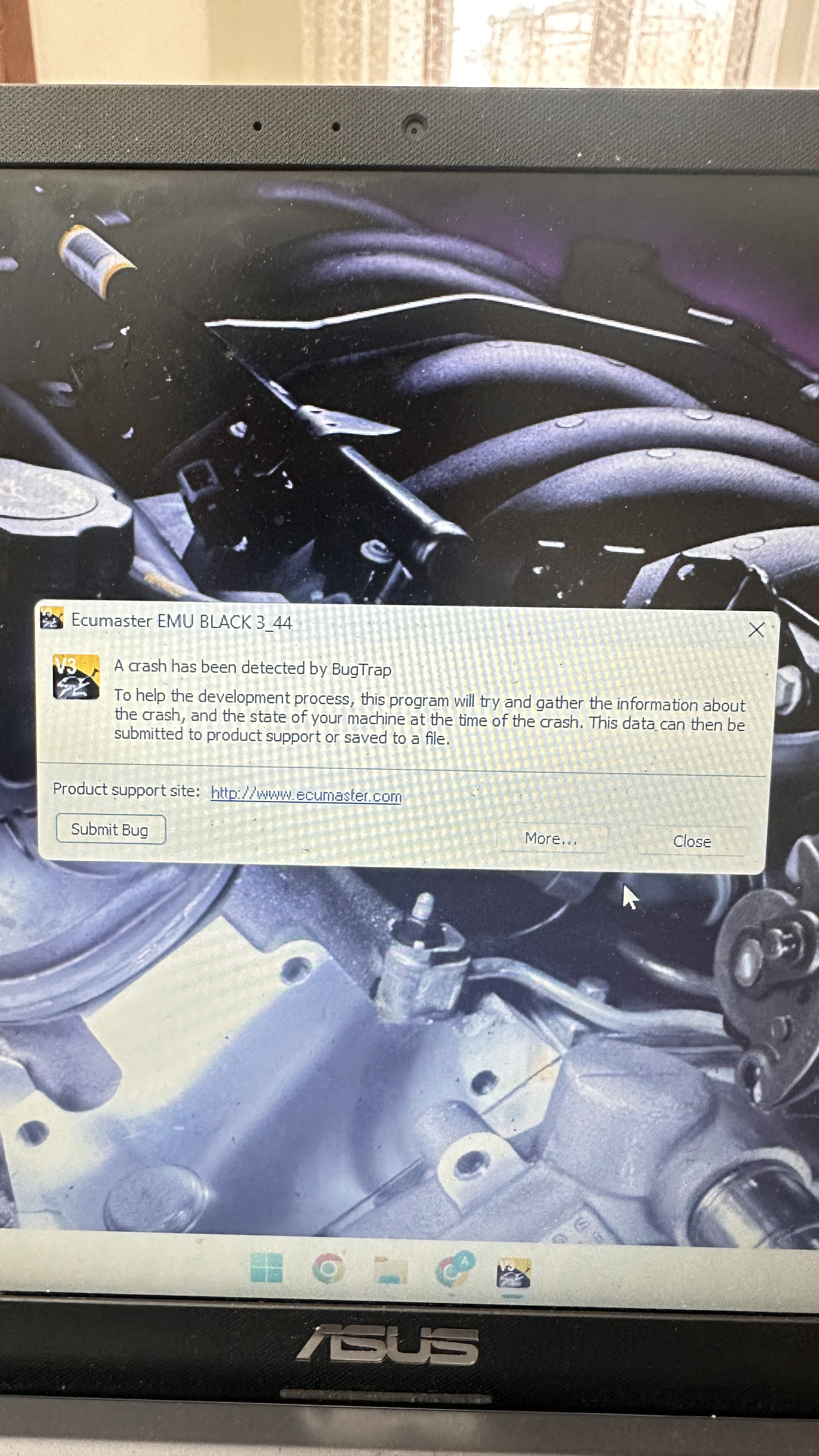

Tried using the file import tool. Crashes the app.
EcumasterEMUBLACK344_error_report_250214-075214.zip (2.1 MB)
There is a bug in 3.044. However importer is still in early developing phase

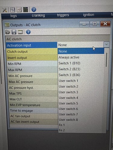

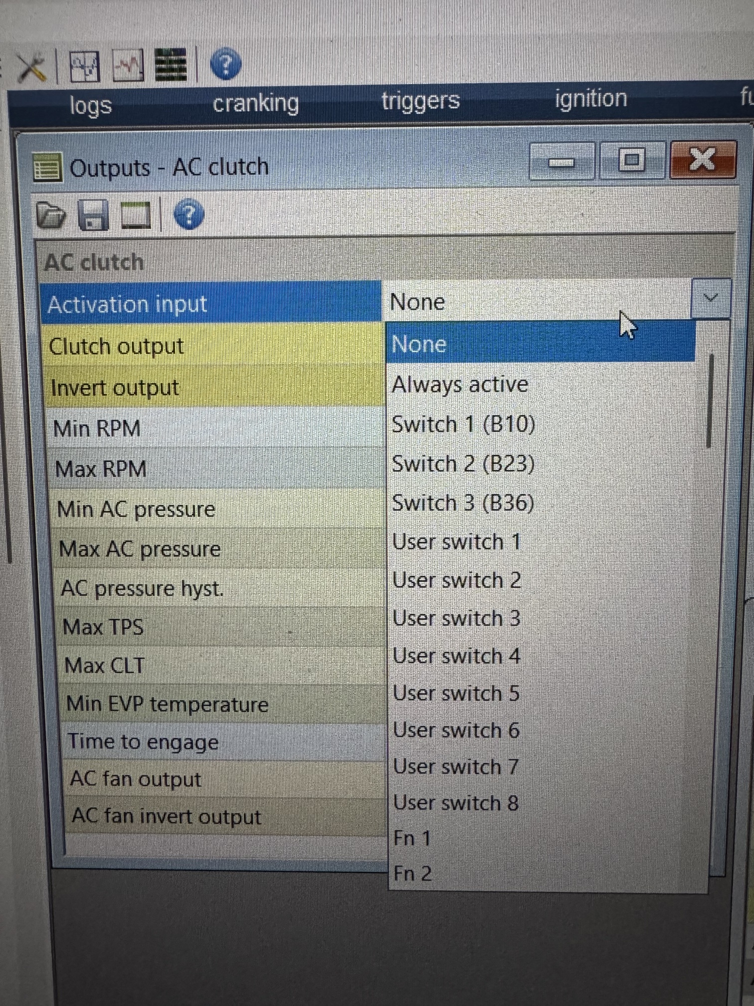

Is it possible to add Analogs inputs for the activation inputs for A/C?? In the V2 I have my AC input set up with analog input #5 but in the V3 there is no Analog inputs to choose from the AC activation input drop box
You can use the Functions method for this. To do this, you can-
Set Output to Virtual
Action “Set Output Only”
Create operator in which-
If Analog In #5 is Greater Than/Less than certain voltage, it will activate the virtual output. Under Activation Input listed there, set it to whichever function you created your operator in.
See post - for Functions and its Boolean operators

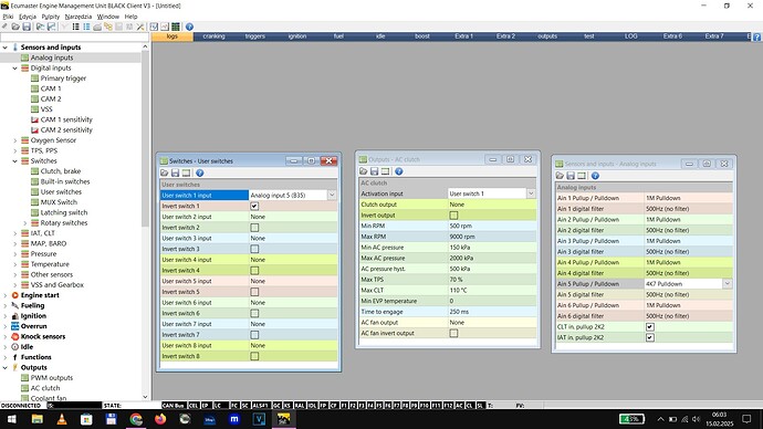

you can select each user switch, then in the tab - sensors and inputs / switches / user switch you assign to which input the given switch is and whether it is inverted, and in analog inputs you set whether it should be pullup
