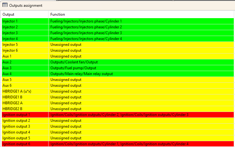

Output assignment dont like wasted spark ignition settings

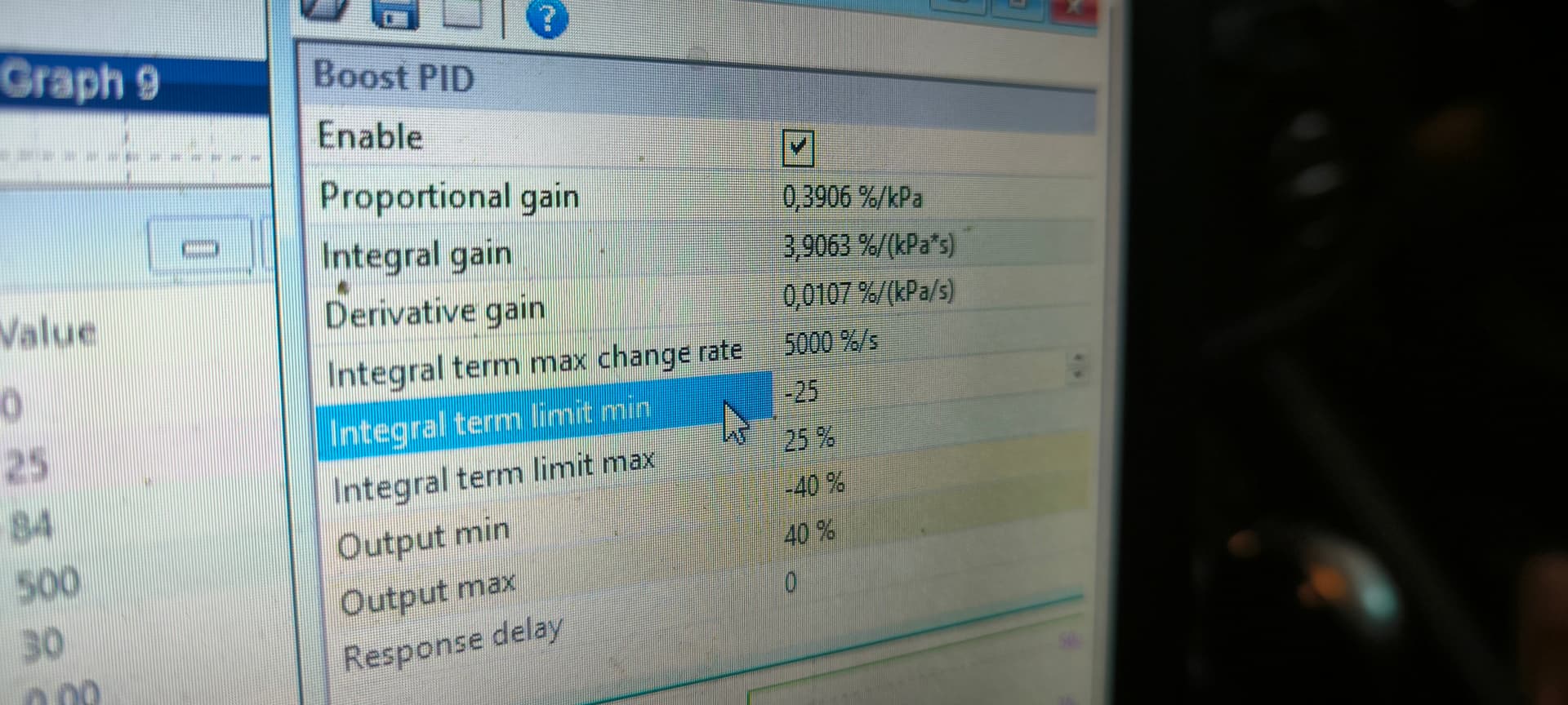

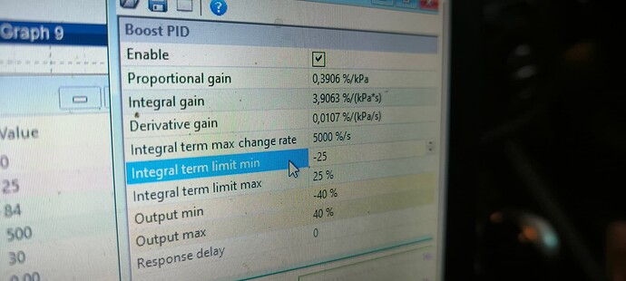

Is there a bug with Boost PID Correction? Boost DC does not change in the newest FW.
