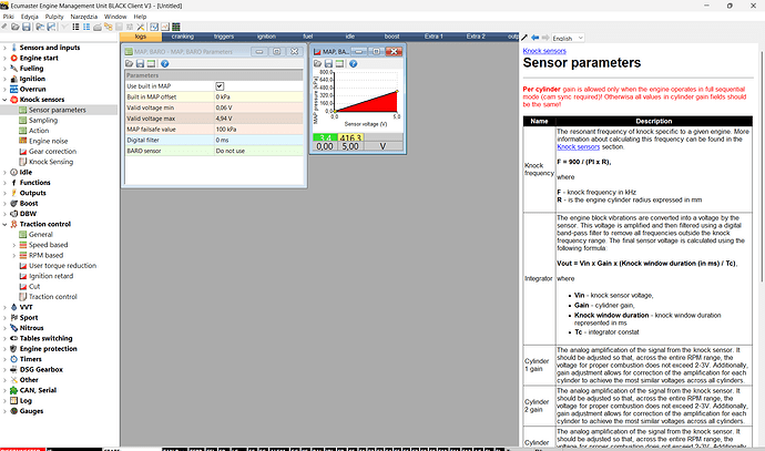

The help section isn’t working anymore since build 3.053.
I get a ‘work in progress…’ message
Could you please publish a screenshot ?
It works normally on our computers:

Can you describe the help issue in more detail?
  1. The help is not present when you start the software?
  2. Does it start to show any content when you change active item in the tree?
  3. Or you always have to change the language for it to start working?

The help section works fine if you select a language other than English and then select English again, so this is probably a bug.
Do you need to do it just once after installaton or always when you start the software ?
I’m not sure what you mean by installation and software?

Okay, I’ve now double-checked and the help displays correctly when I click on an item from the tree on the left. If I click on the help icon in the settings window or the 2D/3D map window, the “work in progress…” message appears. After changing the language, the help displays for the item selected from the tree.
Every time I click the help icon in the settings windows I have to change the language and then the help is displayed for the item selected from the tree
Okay, thank you for clarifying. I was able to reproduce the issue on my end — it will be fixed in the next build. Sorry for the inconvenience.
