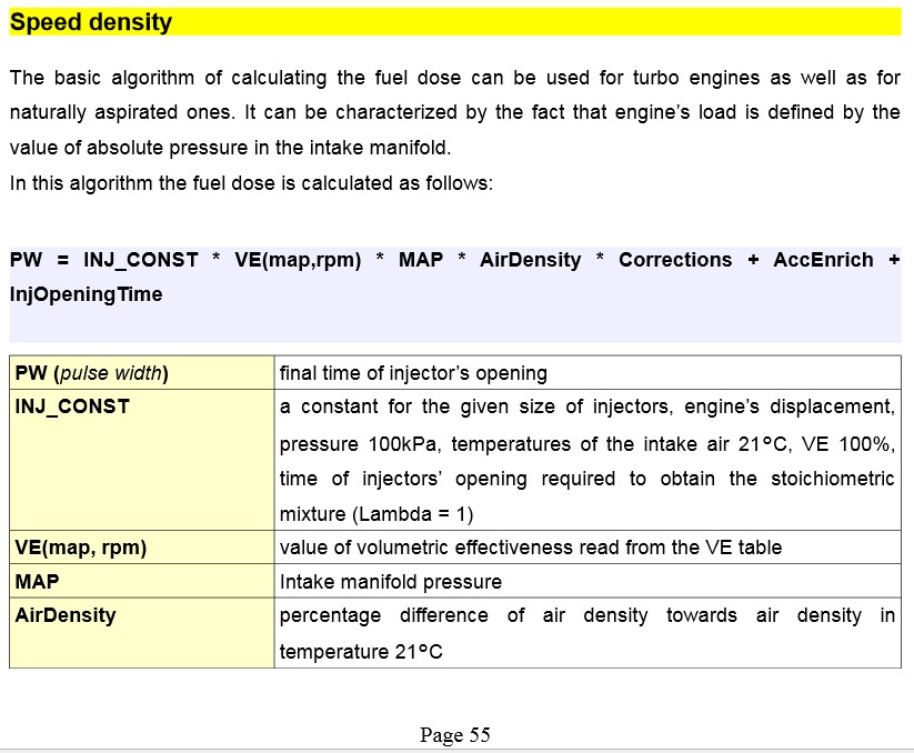

I think that fueling custom corrections are little confusing.
Ie if you want modify lambda target, in options it says “modify lambda target” and unit in table is [%].
At first look you would assume that, in case if your tgt is 1.00 and you modify that with 85% it should be 0.85.
Now, when you try to add 115% it´s actually not 0.85 but it is 0.869?
It is assumed that both type of enrichments will increase the fuel dose for the same amount of fuel. Changing lambda make sens when you use closed loop control.
Otherwise it is virtually the same as changing pw.
And now we can simplify the injectors pw calculations to A * Ve / Lambda target, where A combines all speed density calculations so we can skip it.
So when you use lambda target correction the correction is calculated 1/(correction percent).
That explains “strange” lambda values but is equivalent to increasing fuel dose by correction percent.
