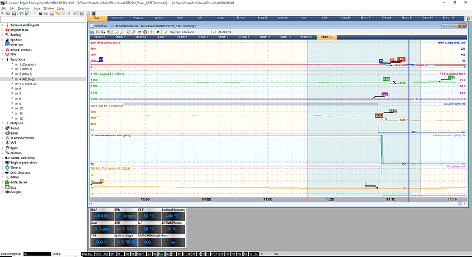

I have set the operating condition of idle airflow custom corr. to AC active, but when I look at the log, sometimes the AC remains ON even when it is OFF (when the evaporator temperature reaches the specified value).
Does this mean that the correction is always on while the AC system is ON? I feel that it would be more correct in terms of control if the correction was turned off when the clutch was turned OFF.
Initially, I thought it would be good to have a parameter that would process the delay when the AC clutch is turned OFF in the same way as when it is turned ON. (I want to suppress the momentary increase in rotation speed due to the loss of load.)
Perhaps the rotation is simply increasing because the correction is always on.

Taking a hint from another topic, I tried to set the AC clutch output to CAN-bus and perform the actual clutch operation with a function.
However, the operation was different from what I imagined.
First, when the clutch is ON, it goes OFF once for some reason. However, this is not always the case.
Furthermore, even though a delay is set, the clutch operation goes ON earlier. And if the OFF delay is made larger, it goes OFF at an earlier timing.
I thought it might be possible to do this with the current specifications, but I couldn’t get it to work properly.
Maybe there’s a problem with my settings.

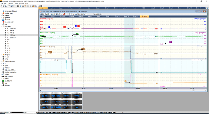

Controlling the AC clutch directly with the function works better, so I changed the setting back, but
the MinEVAPtemp in the air conditioning settings window is somehow affecting it.
Even if you set the hysteresis for the evaporator temperature on the function side, the timing (airflow compensation) will be off if the same setting is not used.
Airflow compensation is set in the function, not the AC.
It seems that the clutch release delay I’m looking for can be achieved by using two functions.

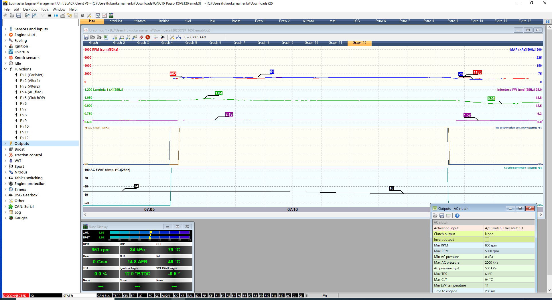

Currently, this setting works perfectly.
QNC10_K3VET22.emub3 (69.1 KB)
However, I’m setting the evaporator temperature hysteresis in Function, and if I don’t set it to the same value as the EVAP temperature setting in Outputs-ACclutch, the timing of the AC clutch and correction will be out of sync.
The cause of this issue has not yet been investigated.

Additional Note:
It said that the evaporator temperature hysteresis set in the ‘Function’ and the AC clutch operation were different, but the reason I checked the log was because it was ‘ACclutch’. I should have compared it with Fn6.
It worked correctly.
