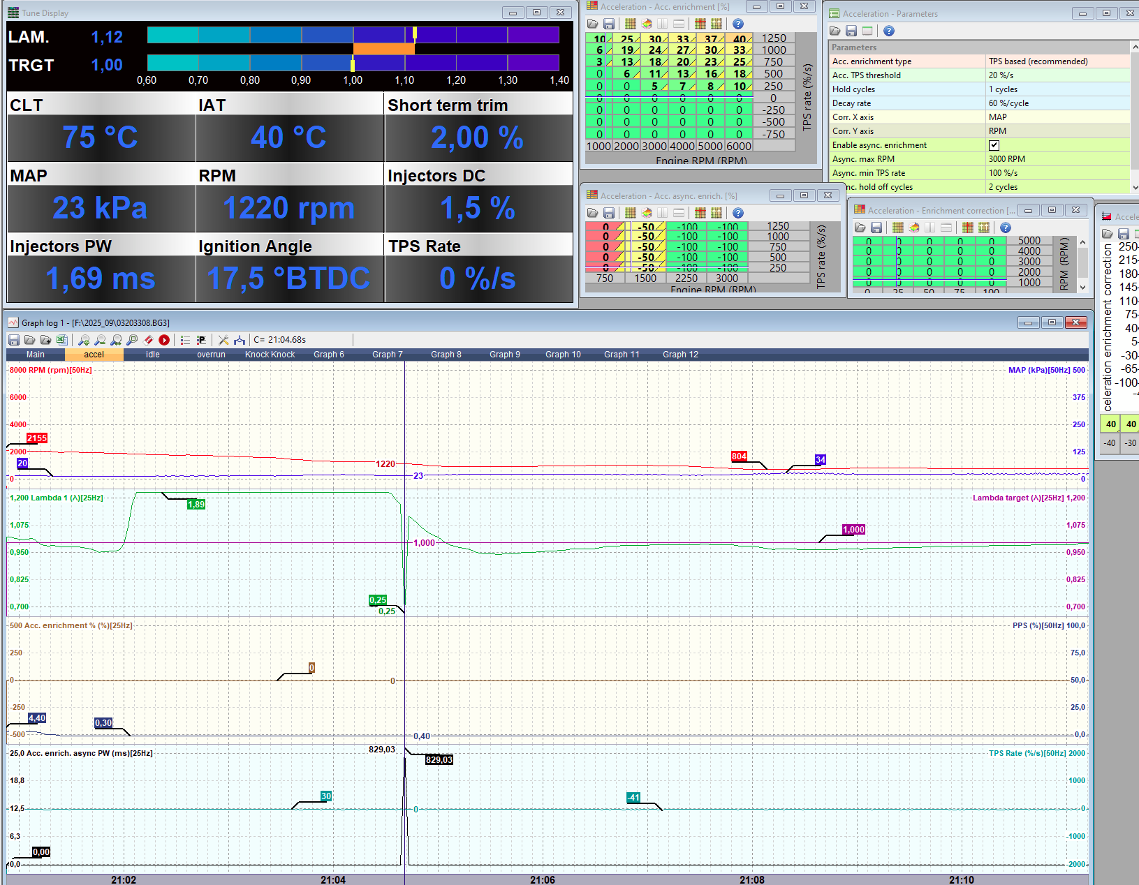

Hi I’m currently seeing weird lambda spikes paired with a weird async pw spike.
What is causing this? The async pw spikes up to 800+ms for a split second and lamba shows 0,25 for that time, after that lambda looks normal again.
I can provide log and map if needed.

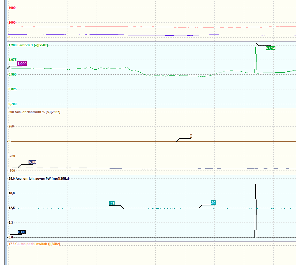

I also see this behaviour but with lambda reading spiking to 63?
This seems very strange to me, either the EMU is behaving wrong or the log is wrong?
The logs are from my EDL-1, i will check if i have the latest firmware flashed to that.
Please attach orginal edl log file. What firmware do you use ? In the past there was and error in async enrich that can cause wrong injection time.

I’m running client 3.055 Exp.2 and EMU Black firmware 3.055.
My EDL-1 is on 1.21.
Log containing the problem is attached.
03192836.BG3 (6.8 MB)

I’ve just seen there is a log channel about edl write errors. Every time I see the weird spikes in the log, it says edl write errors. So I assume this is more of a logging error (EDL, SD card etc.) instead of the emu behaving wrong. I would also assume I would feel (even if it is very short) a lambda spike to 0.25 while crusing..
You can use Functions to do that. Connect switch to switch input and make a function that will trigger Injector output for 10s after the switch was pressed.
Your observation is perfectly correct. It is a logging issue (problem with sector write), not a lambda issue.
You can try to use different sd card.

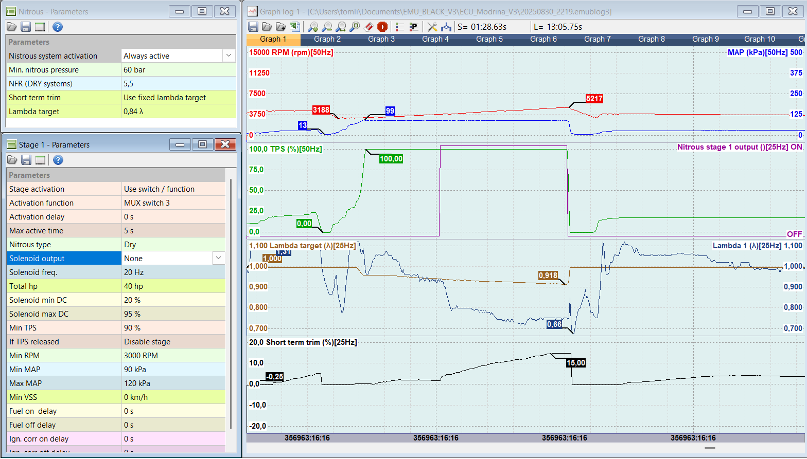

It seems to me that the short-term trim reacts in the opposite direction when nitrous is activated. It would also be useful if the lambda target reflected the correct value during nitrous activation.
There is a small typo: “Nistrous system activation.”
It would also be useful to have an option to invert the H-Bridge outputs directly in the strategy, or at least a general setting to invert initial/default state of H-Bridge outputs elsewhere. Currently, as I need low side when active, I need to use a custom function, to invert the signal, which is not perfect as there is a brief activation of solenoid every time the ECU is powered on.
