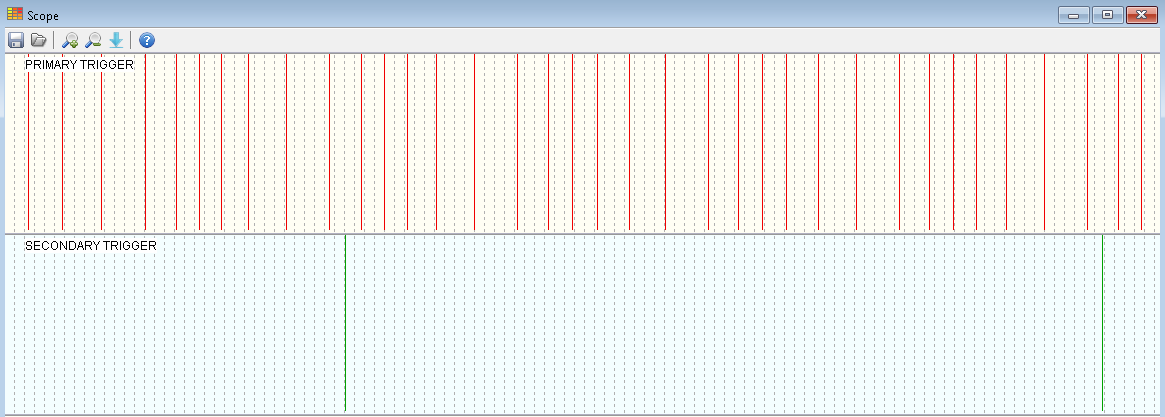

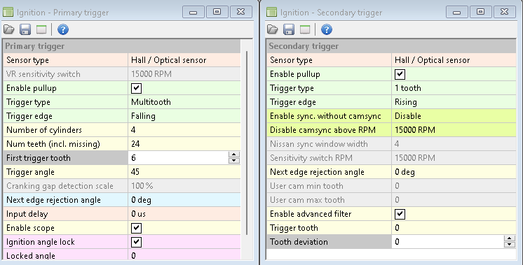

trying to set the trigger angle on my motor. Honda B20V turbo using the infamous AEM epm for trigger. i am getting proper sync when cranking with no sync loss. i am trying to set the trigger angle but all changes the spark fires the same place whic is after TDC. any suggestion appreciated
i will attach a copy of the scope log and trigger settings for reference.
