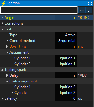

how can we setup up the stock 13b-rew ignition system, where primary ignition is using one coil with wasted spark for both rotors, and trailing is using 2 coils with direct fire?

can someone from ecumaster team confirm that this is correct and that wasted spark for leading ignition will work when assigning output IGN 1 to both rotors in sequential mode?
Rx7 FD stock ignition system is wasted spark for leading ignition and direct fire for trailing.

This is the way to set it up. Both ignitions moment will be done on the same coil. Coils has the 2 spark plugs connected so they both will fire.
