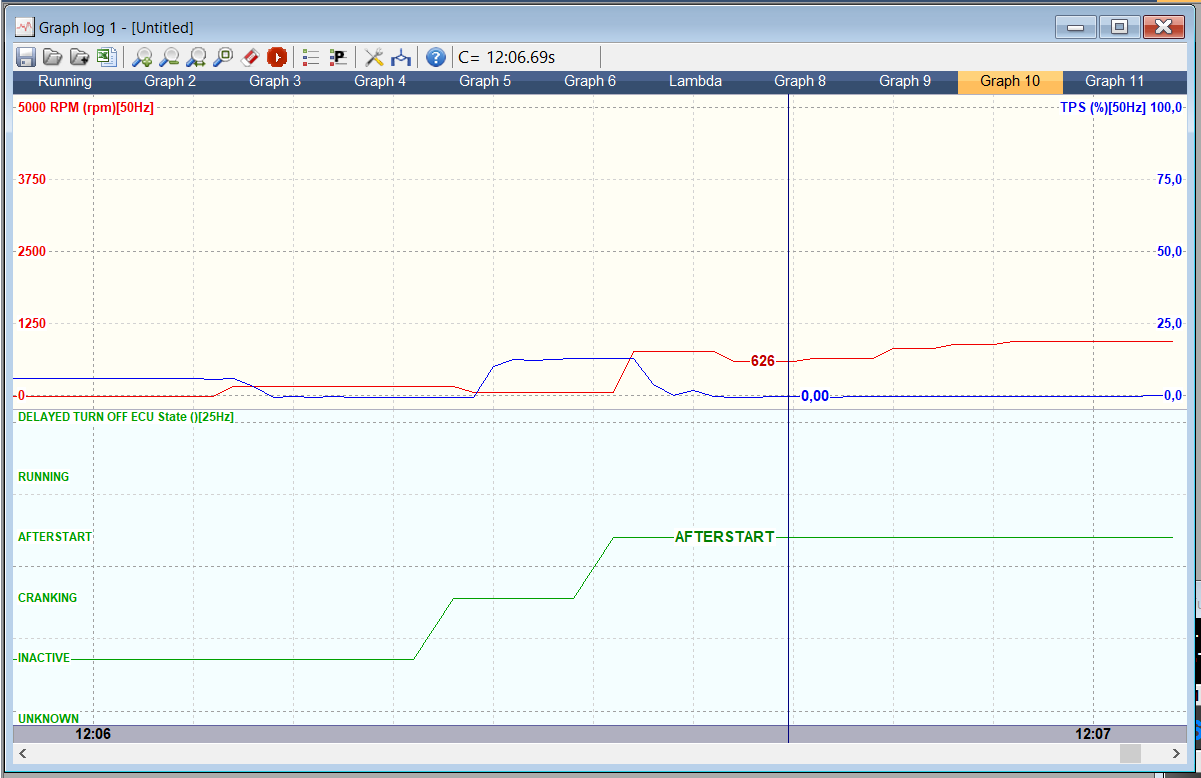

  • It took me forever to find the coolant fan DC correction. But even with that active engine dies. what’s the second thing i have to do to get engine a bit higher RPM for coolant fan? (I have set a activation Delay of 1000ms for coolant fan.)
and one more: afterstart puts my TPS on 0% for a short time which almost kills the engine. any idea why?
Firstly charge DBW blending need to be higher than max target form characteristic will be applied when you off the idle also look what in on Y axis on air flow - it is “target RPM” you cant have lower percentage for higher target or the same value as lower value also percentage on this table there is NOT throttle precent but percent of range between target min and max so your 2% is very very little considering min throttle you have min set to 1.2 percent
