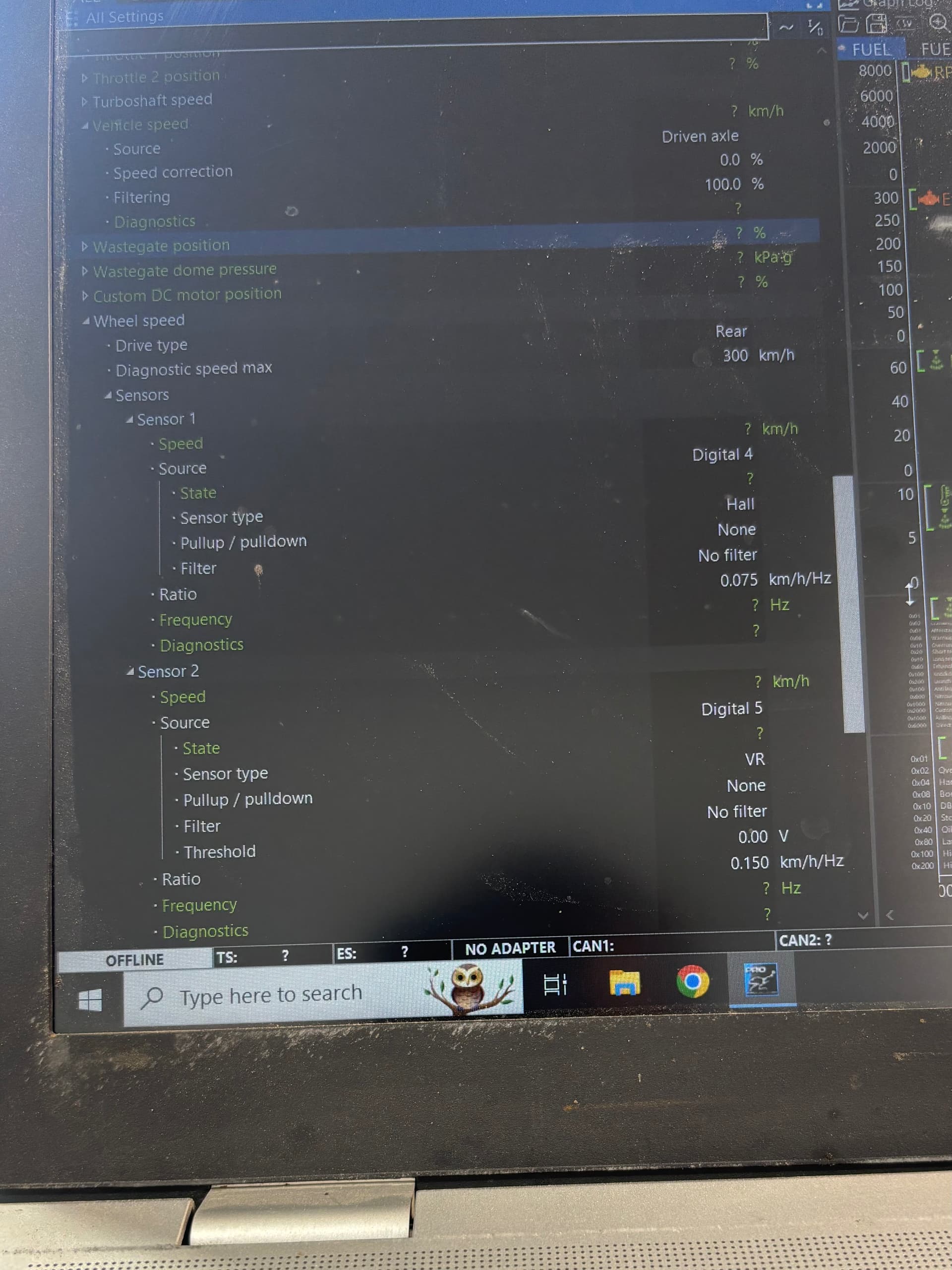

I am having some trouble setting up vehicle speed. I am using a VR ABS sensor in the right front and a hall sensor at the transmission output shaft. I get a good reading from both of them but total vehicle speed still reads as 0 so my ADU still reads 0 MPH. Here’s a pic of my settings. Am I missing something?

Actually disregard that log. Just realized I didn’t have the wheel speed sensors assigned to wheels yet. I’ll get a fresh log in a bit.
I updated to the new beta version and took a drive. The speed works fine now.
