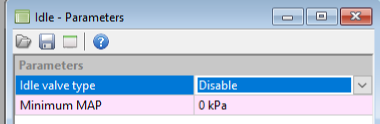

Ur throttle is fully closed all the time…also u have no idle valve configured. Short…ur engine doesnt get air.
Set idle valve as DBW then set a useful crankingvalue…anything else u do with idle dc ref table.
