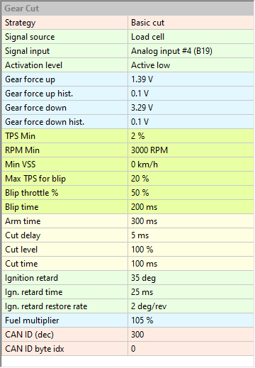

I’m running a Honda K24 setup with an ECUMaster Classic ECU, a dog box gearbox, and a gear lever equipped with a load cell.

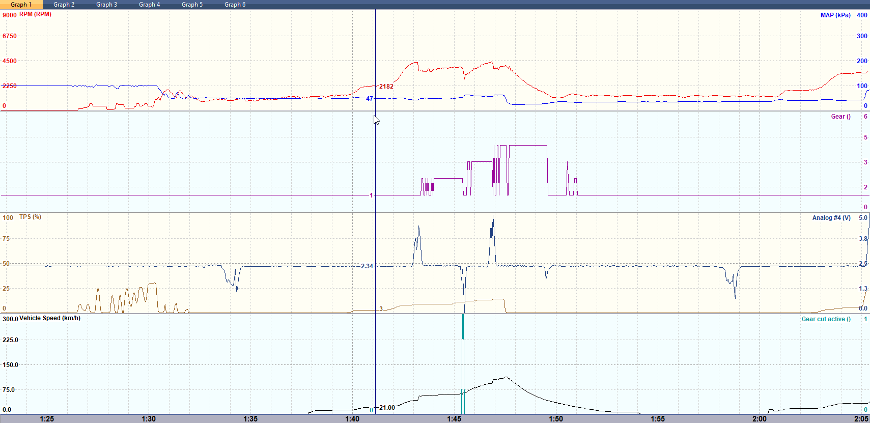

Right now, gear cut only works when I’m shifting up into 3rd gear. When I try to shift into the ones where I pull the lever down (like 2nd or 4th), there’s no cut happening.
I checked the logs and I do see the gear shift signal coming from the load cell. Everything seems fine in the data, so I’m not sure why the cut isn’t triggered in those gears.
