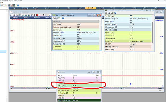

Is it normal for the VVT outputs to be flicking on and off without the engine running? I noticed it when checking the state of another output.
If you watch the circled field you see the output names momentarily appear, can also be seen on the log as red marks…

It is known issue, already fixed for the next version.

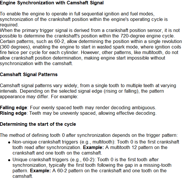

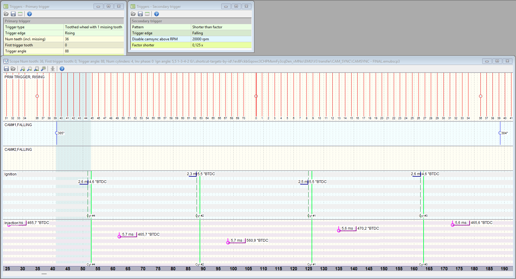

Then I didn´t get from the manual how CamSync works. To be specifiic, I didn´t get the diference between following settings:
One tooth (which I am using on my engine) and which DOESN´T WORK and it should!
Shorter than factor - which works well but I have no idea why.

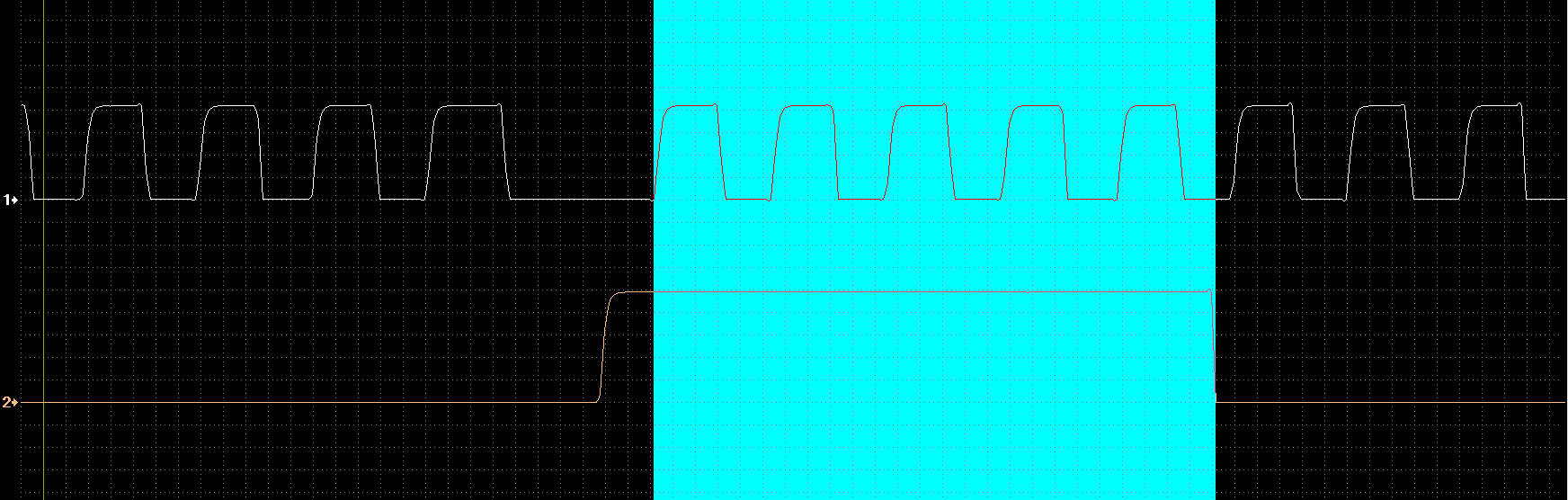

Both SW settings are using the same HW setup which is measured down bellow via osciloscope.
This is CAmSync topic is not relevant only to 3.044

- Accroding cam synchronisation in 3.044 there is a help for cam synchronisetion added (below the picture with the begining of the help). In short when the camsync occurs the next gap on the wheel is the beginning of the cycle. What is strange on your scopes the camsync pulse appears in different places. Once after the gap and once before the gap. Is there VVTi ?
The injection and ignition is synced to the primary trigger tooth not a tooth on cam. The tooth only shows the engine phase.
