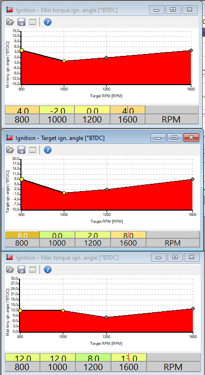

RFE:
Can we have those three tables combined into one?
Having a plot with target min and max values in a single window would improve readability of those tables and their correlations. Also it would not take so much space in the desktop area :slight_smile:
Thank you.
