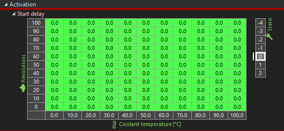

Could you use the table as 4d and use a dual qualifier, coolant over revolutions over cranking state?
A 4d table wouldn’t help, as soon as state is 0 or 2 it’ll use that slice of the table but Revolutions will already be high.

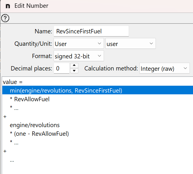

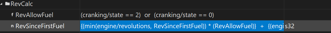

Here’s what I tried:
Basically RevSinceFirstFuel = choose(RevAllowFuel, min(engine/Revolutions, RevSinceFirstFuel), engine/Revolutions). But since you can’t have nested functions I used multiply-by-a-boolean and multiply-by-1 minus boolean to simulate it.
If logic functions supported comparing two channels (rather than a channel vs a constant) then the logic could be simplified to:
RevUpdate = ((state != 2) AND (state != 0)) OR (revolutions < RevSinceFirstFuel) RevSinceFirstFuel = choose(RevUpdate, revolutions, RevSinceFirstFuel)
but either way I need to burn a status variable to accomplish what I want.
I should note the above solution is only half the solution - RevSinceFirstFuel is really RevOfFirstFuel, so I still need another variable to be EngineRevolutions - RevOfFirstFuel. Still doable with the math features of Project Tree, and it’s nice that there’s a Group function to put all the substeps together in one place.
