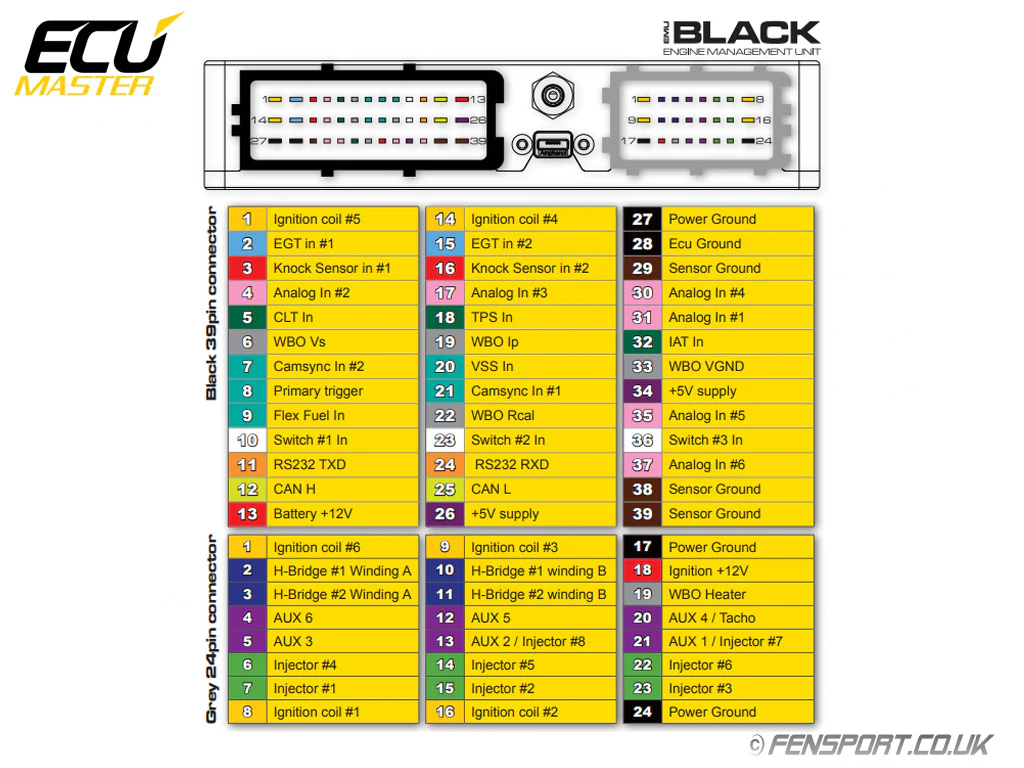

I must be blind, can someone point me in the direction of assigning the flex fuel input.
pin 9 on the black connector is flex fuel input
Black connector pin 9
Is this newer then rc2?
Thanks, I was looking in the software to assign the input. I see it’s a dedicated input.
