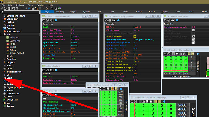

can we make the arrows on the menu white ? on my laptop with win11 they become invisible when i click on them xD
And on my desktop they are barely visible

It is strange because on my computers it looks correct:
I think it could be connected to the system colous (your app bar looks like non standard windows color). I will try to reproduce it and find a solution.
