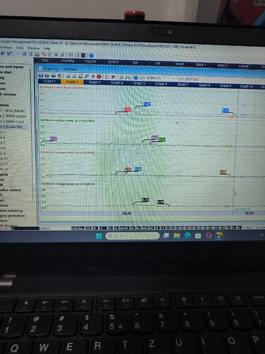

Maybe I’m too stupid. But I’m missing the knock engine noise. IT is a nice feature, to show, the Knock cylinder Voltages, but in my opinion IT was much easier, only to had a comparison from knock engine noise vs. knock sensor value.
Is it possible, to add a “knock all peak value”?
Knock engine noise and knock level peak channels exist in v3
Knock Level Peak is always zero
It’s a pity that Bank1 cannot be set for two outputs in the secodary fuel line function or two outputs per cylinder. I’ll stick with version 2 for now and try to make a gentle change on the loom for test V3. THX
When knock voltage exeeds knock engine noise you Will see knock level peak

you need to set the maximum value of the graph to 5v. its standard set to 20v as i remember. right click and change it
